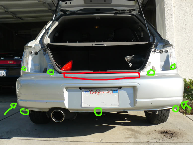

okay all the green spots are the areas where i took out the clips and nuts. and the bumper is loose and moving freely except for the area circled in red. any ideas?
Old Aug 21, 2008 | 06:10 PM
AutoHQ's Avatar
Former Sponsor
Posts: 1,199
From: Mountain View, CA
Car Info: Shops cars: 07 STI & 07 Lotus Exige S
Originally Posted by MrMakesItRain
it looks like i got all the clips and nuts and screws including the ones behind the taillight but theres still something holding the top of the middle of the bumper on. any ideas?
There are also 5 clips on the top lip of the bumper. You have to lift your rear hatch seal to see those clips. Just use a slim screwdriver to get in there to pop those clips. They come out real easy.
Have fun putting them back in..
--Bryan aka Ballz
