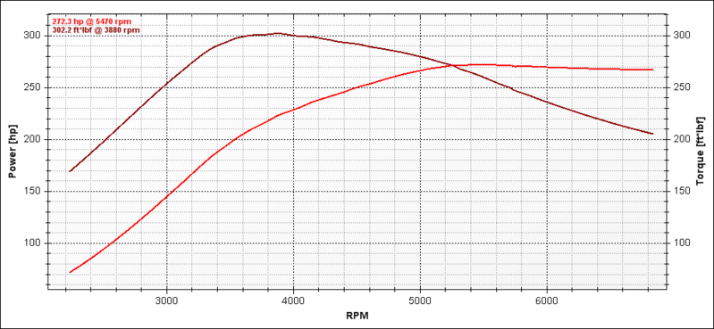

Well finally I have my car properly tuned and it feels great. Ed did an awesome job and I couldn't have asked for a smoother power band. The nicest thing is the boost response which kicks in fairly quick and pulls right through to redline.
Car: 04 STi
Performance Mods: Titek catted DP, SPT cat back exhaust, Hallman MBC

wow nice power
for a catted downpipe
and very lil mods
take the cat off and have ed retune
i can see prolly 280 - 285whp
yup
ed is pretty gangsta
with my 277whp car
i ran 12.6
and 12.7 i only made two pass

Ken, thanks for the review. Your car made awsome power for being catted and as quiet as it is. I'm also glad we caught your fuel pump as it was starting to fail rather than once it had totally crapped out like several other cars I've seen.

Hey Sean yeah I know your car made some nice 1/4 mile times. After I take care of some other stuff I might get tuned with race gas just to have that option when I feel like going fast.
yea dude take care of those "some other stuff" and get your car tune with race gas and maybe add more mods, then go after my stock turbo record ahha
since you have accessport you can switch anytime,
but i still cant believe your car made 272 with jus catted tbe
thats fast
