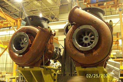

get this turbo

HAW
I've seen plenty of those, prolly becuase i go fishing everyonce in awhile. That thing the guy is standing next too looks like a water pump. I see those all the time at the bay becuase they are dregging out the floor, guess its not deep enough... heh.
