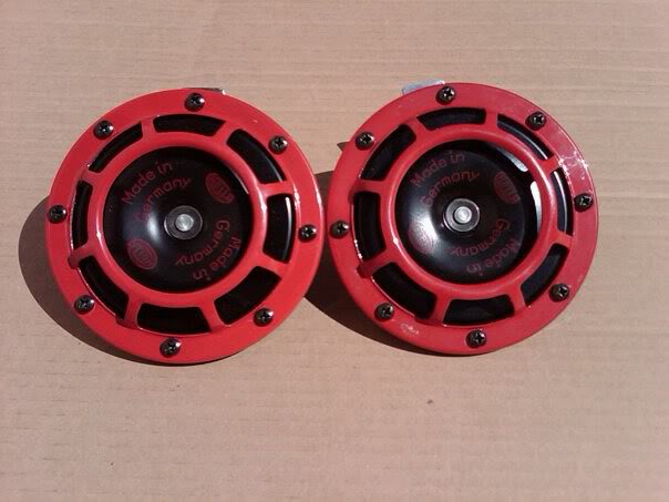

These came in today
Before

haha right on. Ya they just came in today. I just put the first coat of "cherry blossom red" on

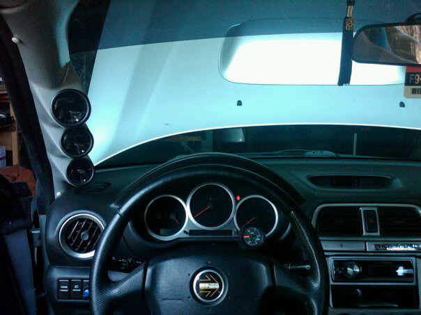

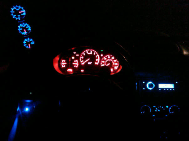

Try to snap a couple pics tonight with all the lights on

now just gotta get the cluster changed blue
almost all the lights are blue in the car now haha
