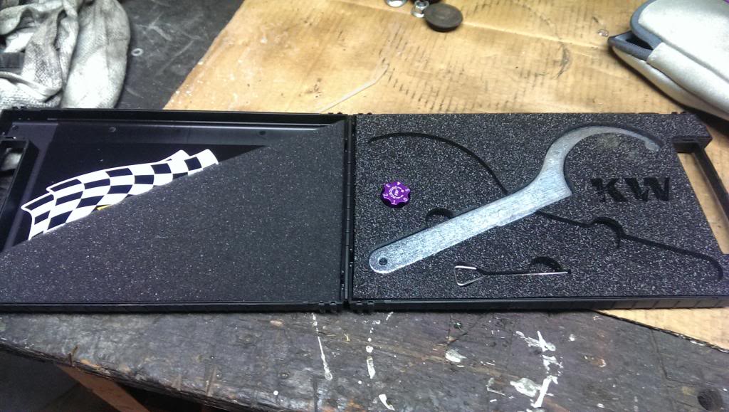

KW coilovers

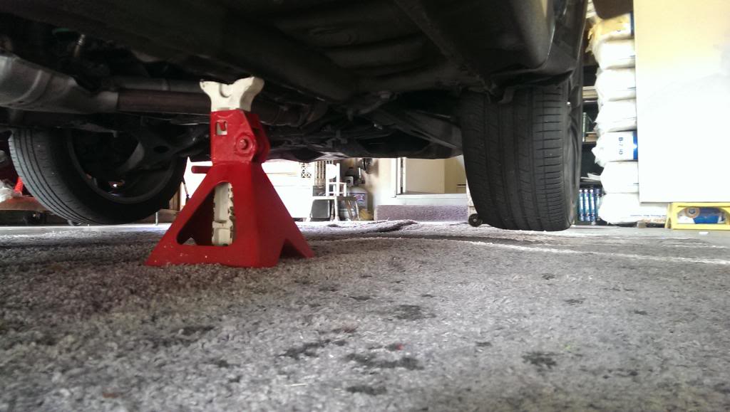

Put car on jack stands

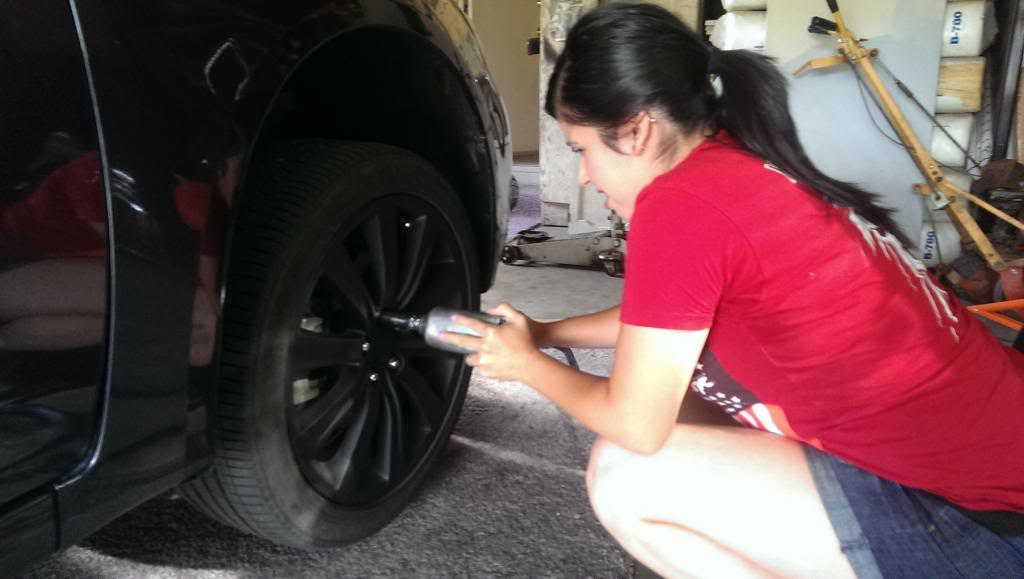

Front wheel removal use 19MM socket

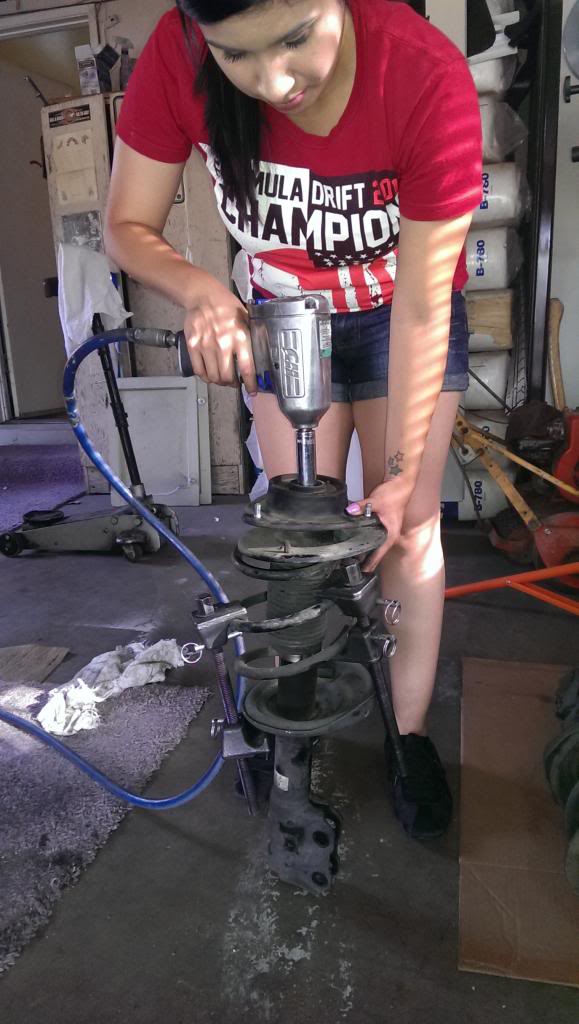

Now I removed the factory OEM mount. I used a spring compressor then impacted the factory nut off. KW supplies a new nut so you do not have to use the OEM nut.

I did see a factory spacer that looks like the bearing spins on after I removed the factory mount. So you will have to remember to use this.

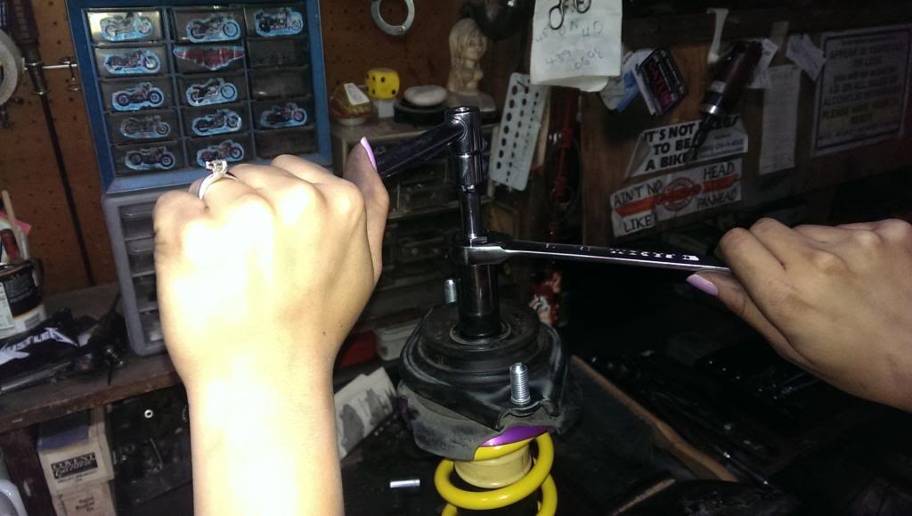

Now time to install the factory mount. I used a pass through wrench. It holds the piston rod in place so you can tighten the nut on without the piston rod spinning. Think of it as a socket that in a socket.

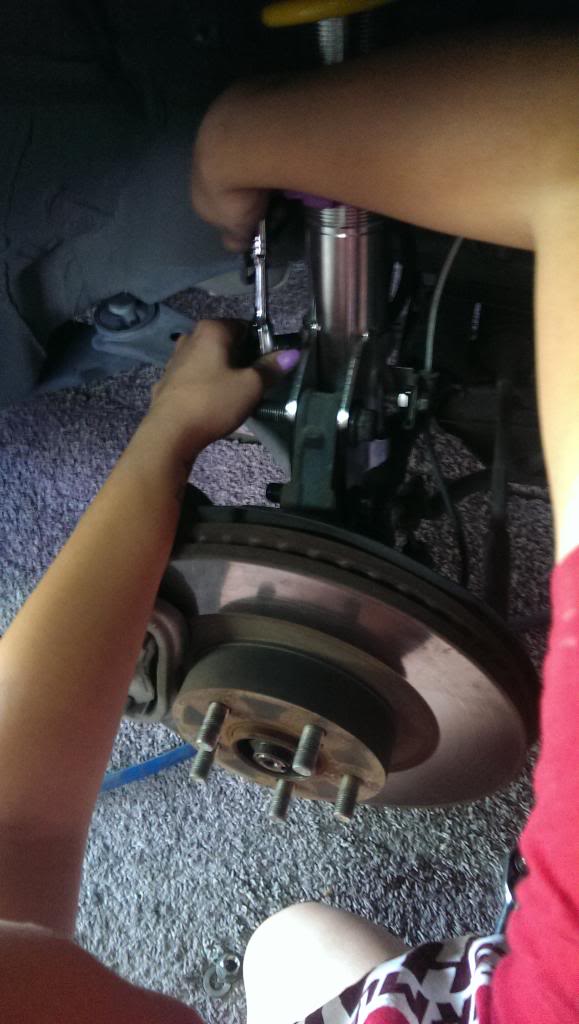

Install the factory 19mm bolts on the hub and reconnect the brake line and ABS senor to the KW strut using a 12mm socket. There is a camber bolt. Remember this goes on the top hole on the strut to hub.

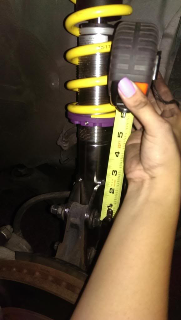

I noticed that KW has a specific ride height range. I went off their “A” measurement since I wanted to install it and adjust the height with the wheels off the car. I set the front to 140mm which is about 5.5 inches from the center mounting point to top of the adjusting perch where the spring seats.

Set screw. I noticed KW states to tighten to 2NM. I didn’t know what that meant so I called them and spoke with Adam. He told me that to tighten it till I feel it touch the threads and stop anything more will strip it out.2nm = to .4 FTQ from what he said. I also asked why there only 1 spanner wrench and Adam stated there tool kit has been universal box and depending on what kit and what time frame KW had different perch sizes. All of their kits now only have an 80mm spanner wrench.

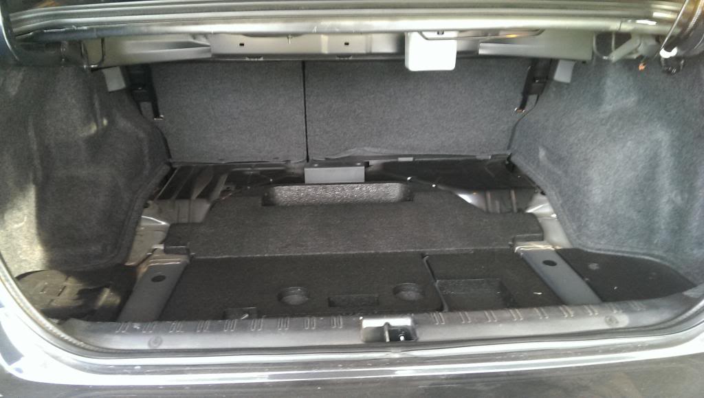

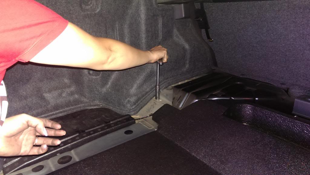

Moving onto the rears. I had to take out my trunk liner to get access to my 2 upper bolts that hold the mount to the car.

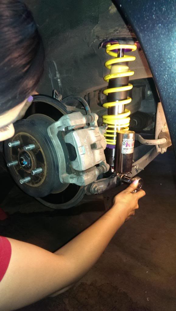

Remove the 17mm nut and bolt that holds the rear shock to the control arm.
I’m really short so it was hard to get to the bolts inside the trunk but I managed to get the job done.

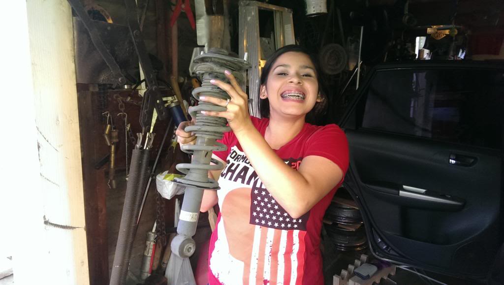

Once again I had to use the spring compressor and impact to take off the factory nut.

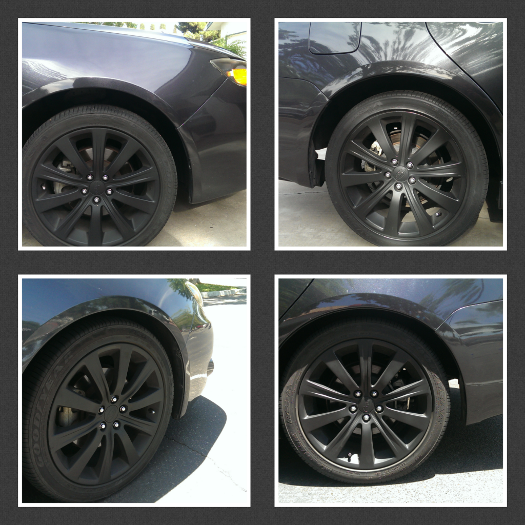

Now install and tq all the wheels down and see how she looks. It was a bit dark once I was done so I took some photos the next day when it was light out.
Before and after. I still might need to down a little lower in the rear.
