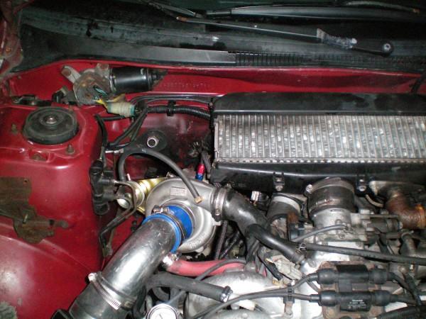

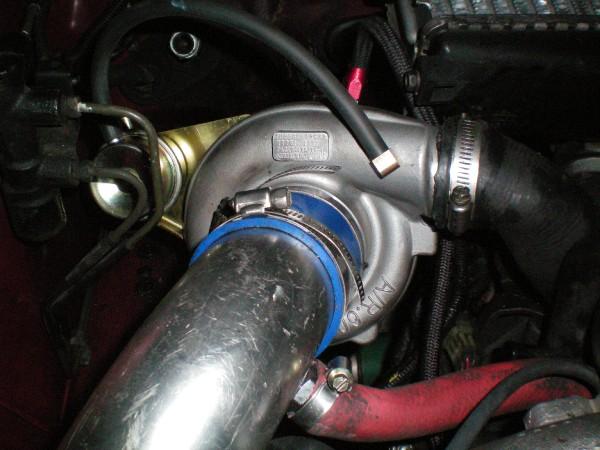

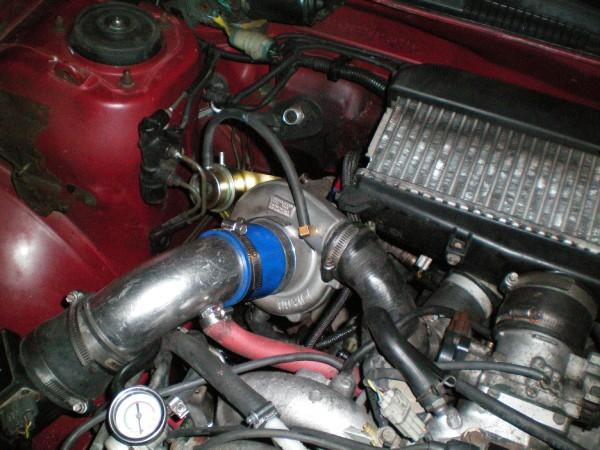

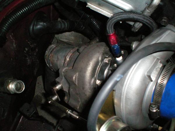

indeed, here is my latest attempt at boosting my 2.2 to death, so far its outlived a vf11, and 2 td04s, NOW its the t3/t4 60 trim to give it a shot....EVERYTHING has to be custom made, and every car is different so i wont have any insight to help anyone out, but if you do have questions, PM me
Attached Thumbnails 60 trim n/a 2.2-zomg-rotated.jpg   60 trim n/a 2.2-60-trim-2.jpg   60 trim n/a 2.2-hotside.jpg   60 trim n/a 2.2-yes-yes.jpg

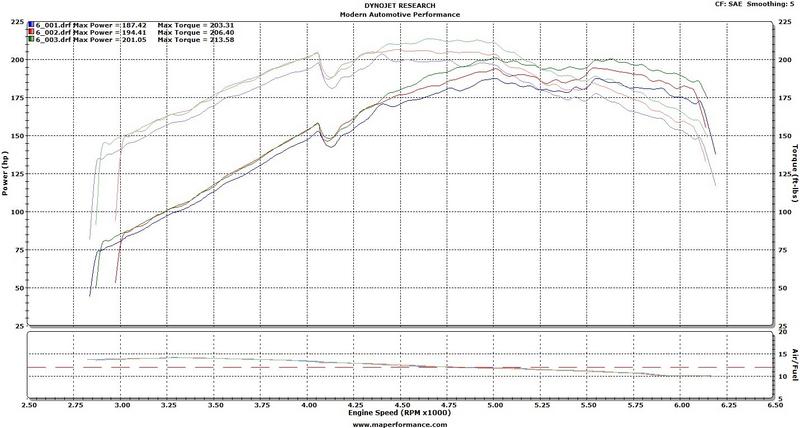

BUMP, its STILL running, it made 201 whp and 213 wtq, still no managment, same setup, on only 8 psi. well over 200K miles now.

Graph of my dyno.
Attached Thumbnails 60 trim n/a 2.2-erik%2520sayen.jpg
